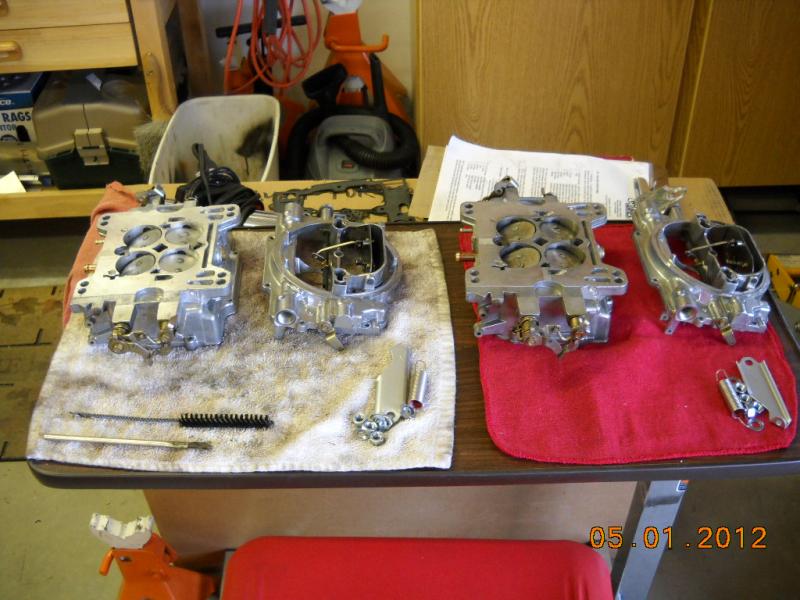

take the top off and look inside.not tuff to do and you shouldnt break any gaskets.will let you see any dirt inside and allow you to clean it out.also,check the accel pump plunger(comes out with top)prob bad due to sitting and may be causing your stumble prob.rebuld kits are pretty cheep and wouldt hurt a bit to do.simple carb and very easy to rebuild.just keep track of how and were each part comes from durring disassembley to alow for easy reassemble if you have never done a carb rebuild before.
In addition, disassemble it on a nice thick towel so that you capture all the parts. Pick up a couple of cans of spray carb or brake cleaner, remove all the parts that are screwed on, and blast the cleaner through all the parts and little passages you can see. If you have a compressor and an air nozzle, blow through all the passages. Pay particular attention to the accelerator pump discharge nozzles (center of primary bores with 2 little brass tubes pointing into venturies). Then while you have it apart, check the float level and drop. Edelbrock has all this info on the web, even a you-tube video on how to disassemble, do the adjustments, re-assemble and tune on the car.
It's easy, just take your time and ask questions here if you get stuck.

I'm going to go for it. Soon as the snow flies I will tear it down and clean everything. It has to help. Thanks for the advice.
