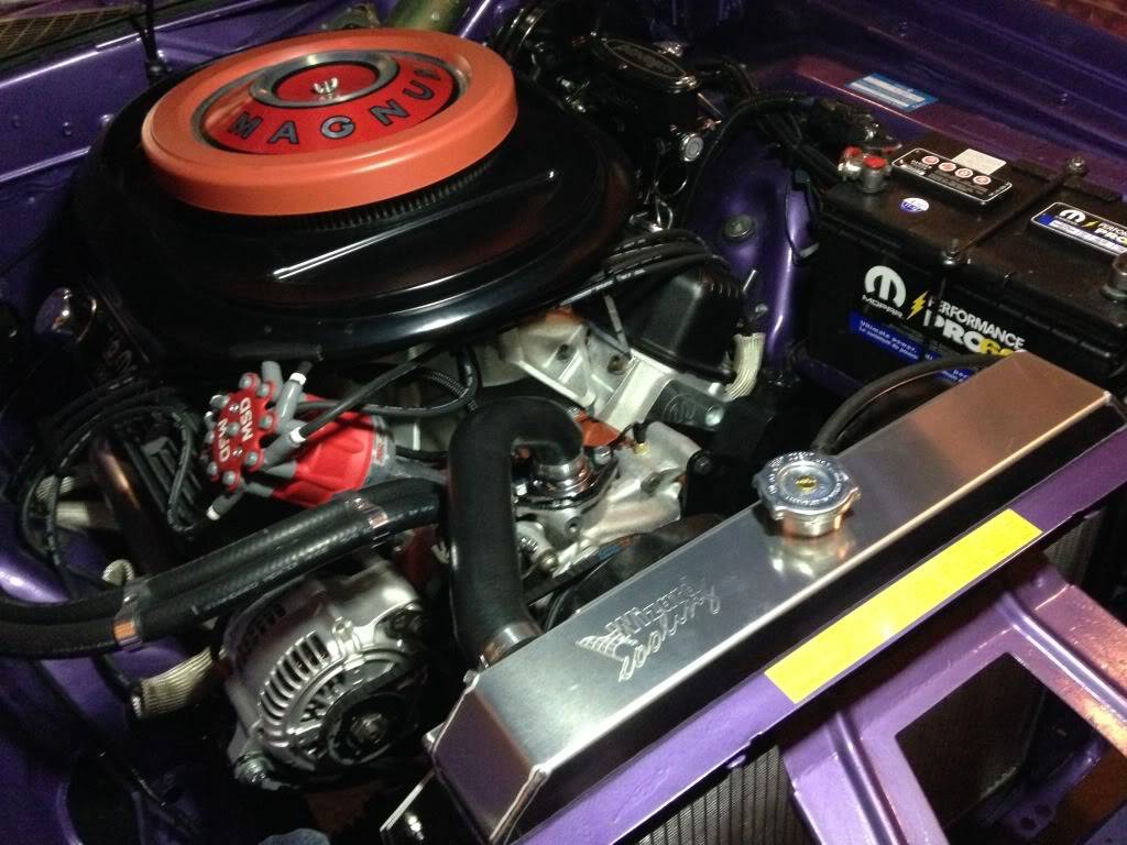

As the title says. I have an 870 Street Avenger and I am considering changing it out and I am curious to what people like out there? I was thinking an HP Holley, but I want to hear about Quick Fuel and Demon opinions too! Here is my build.
512 Stroker (400 block) 513 HP/608Ft/Lbs
MP 452 Aluminum head
Comp adjustable rockers
Comp hydraulic cam 1228 .545 lift 241 intake 247 exhaust
Performer RPM intake
Holley 870 Street Avenger Vac/sec
MSD distributor and 6AL-2 box
Callie's Dragonslayer crank 4.250, 2.750, 2.200
Scat H Beam 4340 Rod
Custom Diamond Piston .045
Power Bond Balancer
McLeod Flywheel
McLeod 6913-07 RST clutch
Tremec TKO600
8 3/4" 3.91
