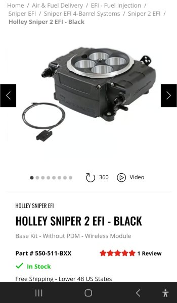

I live in California and my options for carbs are limited . I'm thinking about getting a Holley Sniper 2 EFI. What is you're opinion on this ? Do you think it worth it ? Or should I get another autoline replacement ?

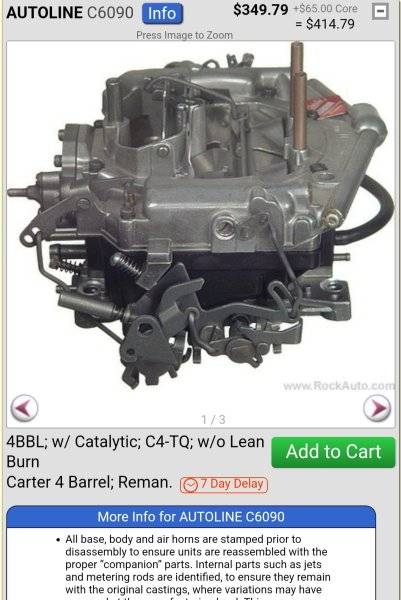

I found that the rebuilds like the ones you are using are junk. You need to find a 75 or earlier good core, have it rebuilt by someone you trust or one of the prodessional rebuilders available. Those mass rebuilders that rebuild these, take a bunch of these apart and when put them back together just throw mismatching sections together. There are a lot of different part numbers of all 3 sections of Thermoquads. They have to have the correct matching sections screwed together or they will never be right. When I used to buy TQs at swapmeets or where ever-I would always bypass a unit that had a rebuilder sticker on it. Many of them looked very nice. I would always try to find virgin cores, you can usually tell, examine the slots in the top screws. If they look nice like they never had a incorrect screwdriver used to take them apart. I'm a big TQ fan, I have a specific good sized toolbox with all the tools I use for the TQ. Nice good quality screwdrivers and good nutdrivers. I do not use these tools for anything else.
Forget about the "brand" name stuck on it, it's a Thermoquad, and I can't offer anything else that the prior two posts have offered precisely. I would've had the original TQ rebuilt by a pro, not a generic rebuilder.
Thanks do you know if this one has a altitude compensator? I believe my original one had it . I'm not sure if this one does ?
I had never seen that little footnote on that claiming they are reassembled with the same parts. But I still wouldn't buy one.

Efi works good too but you are in for some serious work with cables, touch screens, apps etc etc....

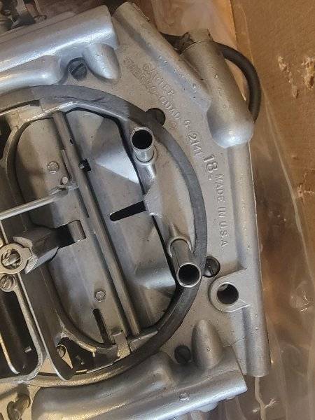

Thanks for the great info , so how do I know if my TQ is from 75 or ealier ? I believe this is the original and it's my 76 that had a lean burn at one point . Here is the photo of my carb with the numbers on the top .
Thanks for the info , how do
The Carb number is on the base, rear, drivers side.
