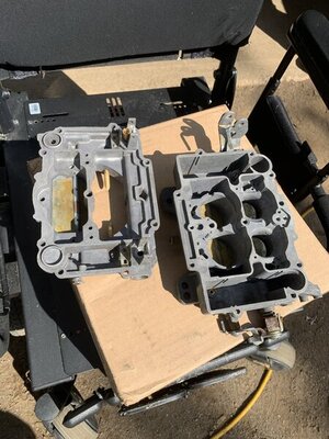

I rebuilding the carbs on my GTX. I’ve cleaned one with CH50 which does a wonderful job of cleaning aluminum. However it leaves it too bare. Any ideas on something to coat them to keep them from picking up every fingerprint etc? I was thinking just Fluid Film rubbed in.

I rebuilding the carbs on my GTX. I’ve cleaned one with CH50 which does a wonderful job of cleaning aluminum. However it leaves it too bare. Any ideas on something to coat them to keep them from picking up every fingerprint etc? I was thinking just Fluid Film rubbed in. View attachment 984761View attachment 984762View attachment 984763 View attachment 984764
The only way you will get a correct finish on an aluminum casting to look O.E.M. is glass bead,chemically clean and ceramic tumble.

For cleaning I would not glass bead a carb , a bead could get stuck in a small passage and then your screwed . Soda blasting works fine . Rinse it out with water when done , works better than solvent.

CH50 is a DuBois Chemical product. It isn't available retail that I know of. It's a muriatic acid and quite concentrated. Spray it on, wait five and neutralize with water. Diluted versions can be found in truck stops for cleaning fuel tanks etc. Car dealers use it for a quick detailer for an ugly engine bay. Ask a parts guy at your local Mopar store, he may be able to get some for you. 5 gallon jugs that I know of.
