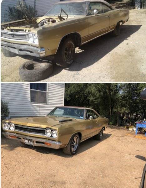

A little background with the car, I bought it in 2017 as a roller. I wired it and did a mechanical restoration
