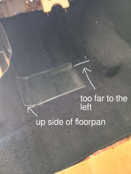

I can comfirm they still aren't putting it in the correct spot. I guess it depends on luck. I'm on my second ACC carpet from rockauto (67 b body 4 speed, black, mass backing). The first was a total disaster. The second carpet is better but the heel pad is probably 2 1/2 - 3 inches too far to the right and maybe an inch or so too far forward compared to your pics above. It's molded nicely and fits all the countours great. Just the damn heel pad is out of place. Comtemplating whether to just live with it or ask for another. It's frustrating.
The pic below is the first one i received where the heel pad is so far left it curls up the side of the floorpan. The second one is better but still placed too far to the left.

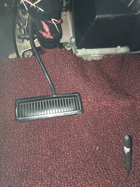

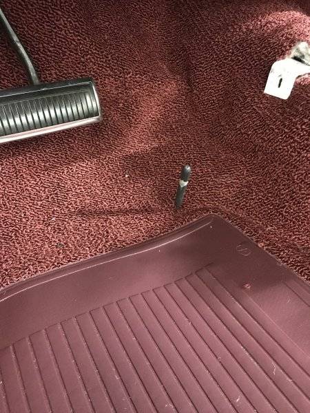

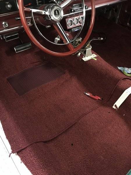

I think I can second that they must not be getting it completely right. I layed the old carpet over the new and it definitely seemed the heel pad is wrong. I marked the cut for the auto shifter off the old and cut it as I figured I had to get everything over the shifter to get the carpet down on the transmission hump and see how it fits. Doesn’t fit good.
The pick is driven through the inner of the 2 accelerator pad holes. So the pad looks about right as far as left-right goes, but it’s a couple inches too far back. I’m guessing I can correct for this by cutting a couple inches off on the upper edge because right now it’s shoved up forward all the way. The cuts for the shifter can be elongated w/o a problem.
Is trimming the upper edge what most of you are having to do?
Had to cut the firewall side of mine for my Dart.
I think I have always had to trim the front side. Especially around the heater . I like to match the carpet floor humps with the floor pan humps. I think it fits better that way.
I have had ACC send new carpet because the heel pad was not in the correct place. Sent them lots of pictures and I also used an awl to mark the accelerator holes.
Are you trimming the upper edge after installation? Looks difficult but probably doable.
I’m not going to have much overlap with the rear carpet after moving it 2” +/- forward.
Just so it overlaps. That won't be seen.

Looks like it’s working out OK - just have a lot of material to trim off at the firewall.
Just take your time and cut a small area at a time. I always liked the extra so it could be fit close and neat to heater and steering column .

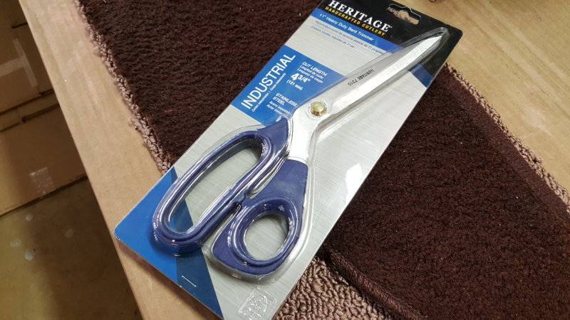

Bought some new shears that are cutting pretty well - except for the jute padding. Haven’t found anything that will cut it cleanly.
I bought these stainless steel sizzors from TSC, $18 and I cut all of the insulation on the floor and all of the carpet trimming with them. I only used a razor for a couple of small holes. They work great and are still sharp!
