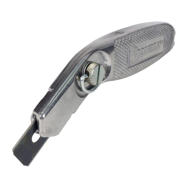

Have you tried a utility knife? You cut on the back not on carpet side. The backer is a different animal.

Those razor type carpet knives work EXTREMLY well . Much better than any Utility knife can or will
Just be very careful, you can loose a finger real quick
Yep, they work good. They'll also slice through your finger like a hot knife through butter. Don't ask me how i know.
