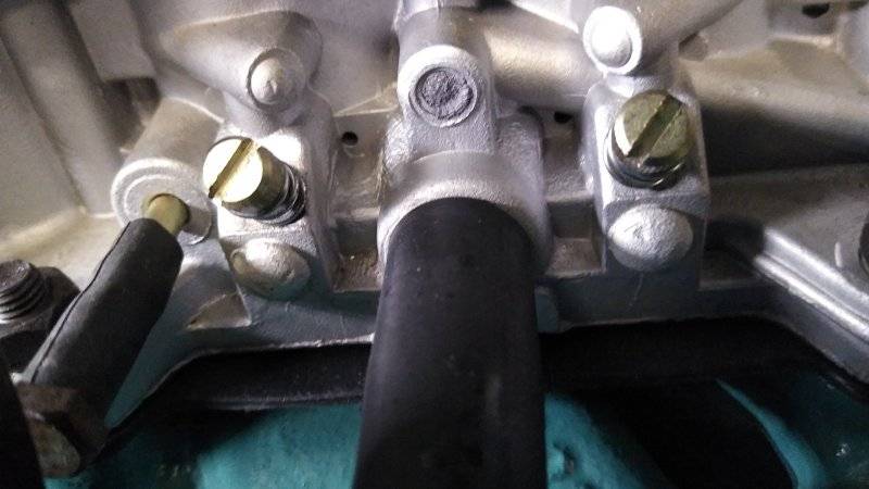

Aha think I sent problem 2 extra holes. Am i correct?
Don't remember seeing those
Those two holes, and sometimes on the secondaries, are vapor vents, used to vent the barrels during hot shut down soak. These are not your problem. Just my opinion of course.
BOB RENTON
Well maybe not. I drug out another Carter and it has the same holes. There are holes on the secondaries also. What is the purpose of these holes?
BOB RENTON
Hey you know more than me. I will continue on.thanks
As Bob said. They disappeared in 68 with the CAP emission carbs, when all venting was captured or meant to be captured. Is the choke pull off used? I see your not using ported vacuum for the distributor. Can you explain why you think it is lean?
