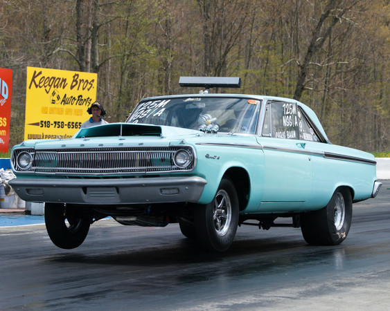

It seems that the racepak is showing me good WOT A/F Ratio but the car seems to have lost just a little 60 foot and 1/8th mile and feels just a tad lazy off the hit.
.119 square now from .116 and 6572 metering jets.
How can I get the car to react quicker and more crisper off the line, like before?
I'm usually 1.26- 1.27 60 foot footbraking at 2400 rpms.
Now it's 1.29-1.31 and going from a 5.75 to 5.83 1/8th mile
I cant remember what I changed other than the .116 to .119 metering jet.
Converter was just freshened and transmission as well with no passes on it yet.
mph is still the same at 149.75-150.12

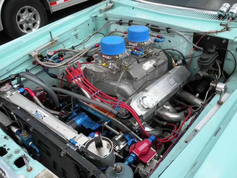

thanks Doug, But I got my best et and mph with .119 jets but now weak off the hit. I know your right about having a bigger primary, but it looks like I need more upstairs. We are at near sea level and need more jet compared to your tracks. If I went .113 I would melt a piston.
