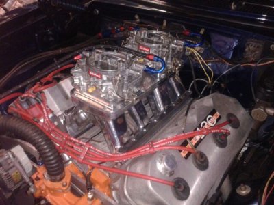

here's the pics of the tunnelram with edelbrocks on top.

Is that an nss legal piece?
As far as I know a bunch of NSS racers switched from the bathtub intakes 440-25 and 426 bathtubs to tunnelrams and no one has complained.Most of the guys are from Ohio. That's why you are seeing more and more indy max wedge crossrams up for sale lately. I'm hoping I pick up some mph and ET with this piece.
I called doug duell on a few changes to their rules and now they are allowing B1 heads in NSS.
I think as long as its NOT a sheetmetal intake you are fine.
