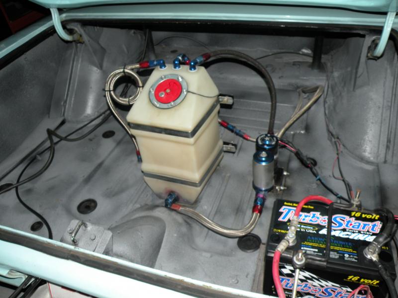

i'm already tapping into both sides with dual inlets so fuel delivery isn't a issue .magnafuel prostar 500 fuel pump with a product engineering regulator with a return system.

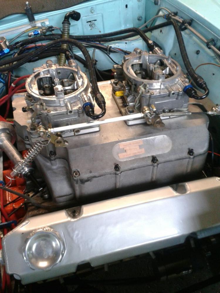

Ok I'm all rejetted and ready to try this out. Put on my other set of Carter Carbs and jetted .121 square and also have another 8 jets drilled to .124 and .123.
