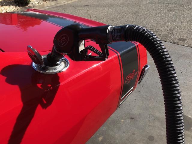

This change of yours is of course possible but at great expense. The trunk floor will have to be modified. I don't know if the top of the quarter panel is wide enough to patch in a Charger section with the gas cap.

I did it on my '68 Coronet, I checked measurements on my '70 Roadrunner and the process would be the same. Pics on post #31 & #32 of this thread:

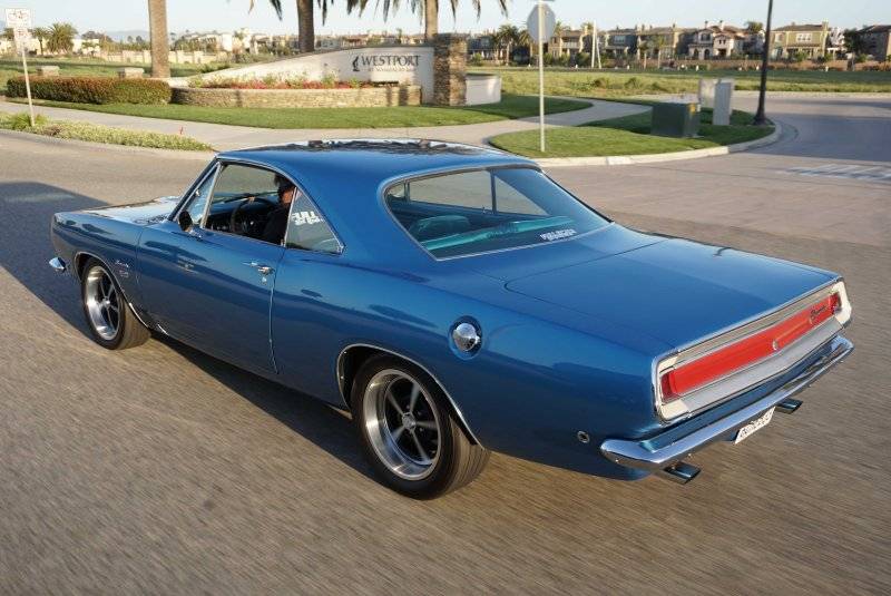

E bodies and A body Cudas had them too

I've NEVER liked the gas fill being behind the license plate but it wasn't bad on my 71 Cuda. It was high even to not have to stoop and it didn't spill out gas like some of them did when the filler was bumper level. And I like the cap location on the 68 Cuda in post 10. The top of the fender location never really did appeal to me all that much...
