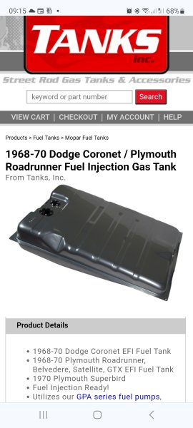

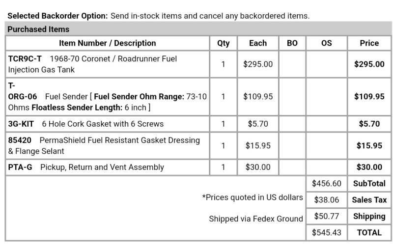

what was the ballpark total cost in parts for your recent order? I've been thinking about a Tanks Inc with this sending unit for a few years now.New tank is on order. As soon as it comes in I will document the changeover in this thread. Decided to go with the Tanks Inc tank and sender as suggested by @1 Wild R/T

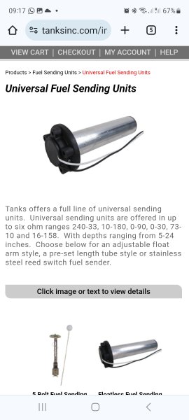

I tried to find stock components to go back in but its very difficult to get them. Spectra have discontinued their ECS tank and finding a decent sending unit is nearly impossible. I thought I found one for $400 but it was sold. I could have used a non ECS tank, but in the end decided to use the Tanks Inc sender as well. Looking forward to an accurate gas gauge reading lol.
Bear in mind that this is for a 70 Coronet, but the prices should be very closewhat was the ballpark total cost in parts for your recent order? I've been thinking about a Tanks Inc with this sending unit for a few years now.
that's some great pricing. And this tank has internal baffling?Bear in mind that this is for a 70 Coronet, but the prices should be very close

Everything is still awesome with the tank, but I did not have 100% luck with the float-less sender and my stock dash gauge.
At FULL it will not go past 3/4, and at EMPTY, there is still approx. 25L left in the tank.
I am chocking this problem up to age of the gauge, rather than an issue with the sender which is the proper 73/10 ohm. I really have never had the stock gauge functioning much since I have had the car anyhow.
In my gauge pod under the dash, an Auto Meter 3315 has been doing the fuel measurement duties for some time since the old tank/sender never read right anyhow. It is basically "made for Mopar" as it is a 73/10 ohm gauge.
Hooking the Auto Meter up shows me full on a fresh fill up. Yet to see how the trickle to empty will go, but will get to in the next few days.
With all that said, having no more fuel leaks/stink & the ability to "fill 'er up" is the best part. If the 3315 works out, I can live with that until a time when I can have my gauge cluster restored.
That's wonderful news, thanks for the update! My stock non-ralley gauge is wonky and never goes past half way at full. I bought a 3315 like you and would like to hook it up. How did you do so without cutting the harness wire cluster connection that plugs into the back of the gauge cluster? Or do have both gauges hooked up at the same time (which I thought could maybe cause a reading error).
No leaks from the sender lock-ring?As you mentioned, it seems to indicate your stock gauge is screwy. Did you measure your float less sender before install with an ohm meter? I am sure it's correct, but just to be sure. My stock gauge reads perfect with my Tanks Inc sender. Everything is stock on my car except now the sender and tank.
, should have, but unless it is somehow faulty, it was the correct sender/ohms by the numbers stamped on it.No leaks and all is working perfectly. I even got the thing vented properly with some stainless tube and some benders.No leaks from the sender lock-ring?![]()
Excellent.No leaks and all is working perfectly. I even got the thing vented properly with some stainless tube and some benders.![]()
