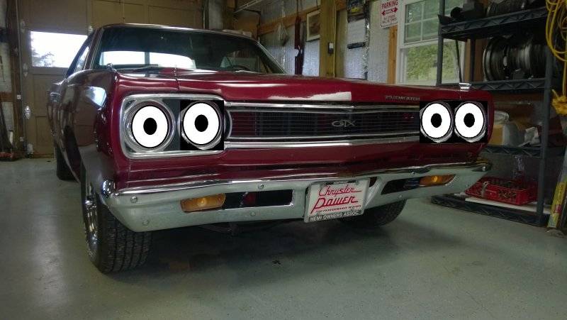

Here locally, the difference between the 93 ethanol blend and 93 no alky is readily apparent in Fred; he runs noticeably
better on the no-alky stuff and gets further on a gallon, too.
(Hint: Check with the closest Co-op; they sometimes offer alcohol-free).
BTW, this is "Fred" on the good stuff:
Fred looks surprised. :rofl:
