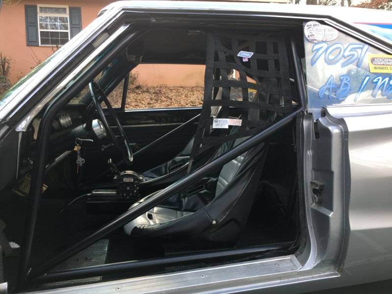

I have 2 coronets. The car I drive is a 66. It weighs 3480 with me in it before I add weight to move it to an index. It has a glass hood, bumpers and deck lid. The 1/4 glass in mine is lexan due to a mechanism breaking. So I pulled them out. Mine at the time of scaling was a stock block 499 with aluminum heads. DVW can vouch for this part, our NSS cars are far from gutted.
My other car is a 67 coronet wagon. It has a fiberglass hood. The rest is metal. It weighs 3775 with me in it. Its a stock block 440 with aluminum heads.
