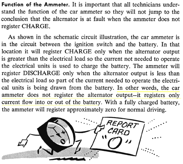

12.2 volts and zero reading on ammeter is very souspicius. It should be zero reading on ammeter and voltage closer to 13 or 13.5. 12.2 volts could/should show a needle slightly to the discharge side, or a needle flickering at least, going to charge side when revving up on more less same proportion depending on how much time was flickering to the discharge side.
Average ZERO READING IS THE BEST/CORRECT status on the charging system at the slowest engine speed ( at iddle if possible ) to confirm you have the right alt for the car requirements.
This is just if all the accesories are correctly connected to the alt side and not to the batt, just like the factory design is/was intended. And of course, the charging network is still in stock configuration

And just taking a step forward before any disagree wich is being floating latelly ( just to bother ) here is a statement from Chrysler literature to support my post.

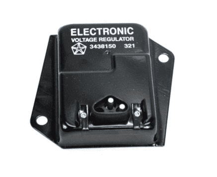

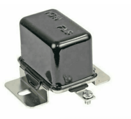

Sounds like your describing a 70 & up style regulator & harness which won't work with a 69 & earlier style alternator....

69 & earlier style regulator

If you can verify which regulator you have we can tell you how to proceed..
Yes sir, I definitely have the 1970 and up style based on the pictures you provided.
I suppose the next step is to buy a pre-70 regulator?
Yes, The 70 & up regulator grounds the field wire since power is fed into the field on the second wire... 69 & earlier the second terminal doesn't exist, that connection is internally grounded... So basically right now your grounding both ends of the field winding... Sounds like you should be up & running in no time...

Update time. Picked up a brand new regulator for a 1968, it looks exactly like the “1969 & earlier style” 1 Wild R/T posted. Removed the previous regulator, installed the new one. Wiring is as follows:
- 12V ignition into passenger side of the ballast resister
- driver’s side of ballast resister wire goes to input (“IGN”) on the regulator
- output (“FLD”) wire on regulator goes straight to alternator field input
Good news: ammeter shows it’s charging. Had the car running, turned on the headlights, fan, and radio and ammeter continued to show the system was charging.
