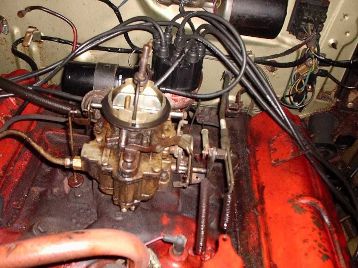

I am working on my brother's 66 BVD II.This spring the alternator went out.No problem I had a good one laying around.We replaced the voltage reg.just to be safe.Everything was fine till 2wks ago. Was checking if it would run when I took the positive battery.cable.. the car would stop running. Some history of events this spring.
1. battery dead,checked alternator-it was bad -replaced with one I had laying around.
2replaced voltage regulator
3. washed engine at car wash-voltage meter started jumping around.
4.Drove it around and the voltage meter pegged.-melted some wires under dash.
5.replaced some wires under dash
6 Cannot get battery to charge now.

Alternator good,pulling fuse box out now.Just looking for obviuos damage.I need to learn how to use this electric multitester.Only thing I know is how to test battery and continuity.
Remove all the connectors at the bulkhead and clean them with a small wire brush or a scraper. And for that matter clean everything you see that is connected to something. You may even want to squeeze the spade lugs so they scratch the male connector for a better contact. High resistance at a connection will produce heat and melt the plastic holder or the wire insulation where it joins the connector. It's possible your field wire isn't making good contact thereby causing a non charging situation.
I also have a 66 Bel II and the gauges were not working consistently so the first thing I did was remove the dash and cleaned the PC board. I also cleaned the bulkhead connector. No problems since.
