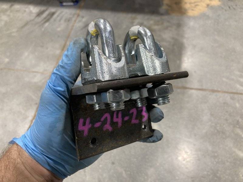

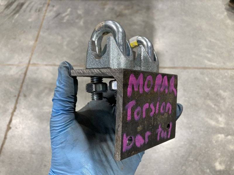

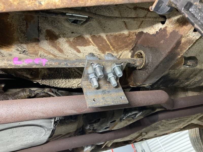

I made a cheap tool to help me remove my small block torsion bars. I got the 3/4” wire rope clamps at Tractor Supply and a piece of scrap angle iron from my scrap pile. I had to die grind the inside of the saddle and angle grind the inside of the u-bolts to get them to go over the torsion bar. Once tightened, it took about three good whacks with a BFH to drive the bars back so I could remove them from the car. I thought others may benefit from this tool idea.
Cool tool, i wimped out a few years ago, and bought the t bar tool from Mancini. I feel so emasculated.
When I did mine a long time ago, I just used a couple scarp pieces of wood (likely 2x4s) with a "V" cut in them - bolted together with scrap bolts. I had a table saw, so that makes it easy... but another way to do it w/o spending $.
