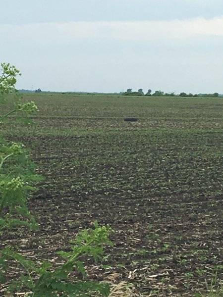

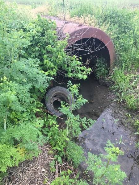

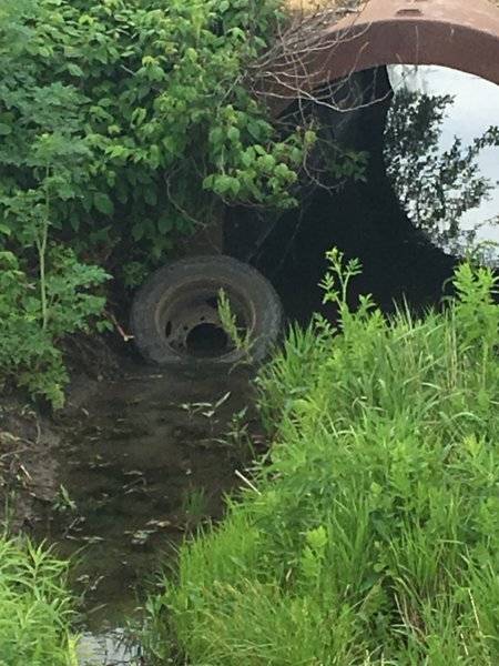

This afternoon I watched a friendly reminder to always check your torque when you get wheels installed. I was driving north on Rt 49 just outside of Casey Illinois when I had to give my little 2015 Nissan a emergency steering test.... I watched the rear set of 22.5 duals come off a flatbed trailer and bounce off the road violently into the air. Ultimately coming to a stop in a ditch and adjacent field. Luckily for me and the other 5 vehicles around there was no damage to life or property. Me Being in the large truck tire industry I’ve heard of these things happening. I’ve gone one roadside service calls to replace tires and wheels for vehicles this has happened to. I’ve even written a tech up for improper install( we were lucky our customer caught the loose lugs before the wheels came off on the road). But seeing it happen 200 yards infront if me definitely makes you take a second and think. Remember you can’t Safely measure torque in “Ugga Duggas” and it’s only an extra 30 seconds per wheel to make sure you, your family and everyone else sharing The road are safe!
Im not sure how they didn’t notice but they didn’t stop so I flipped around to try to follow but ended up losing them before Getting back to Casey so the only pics I got were the lonely wheels left behind
