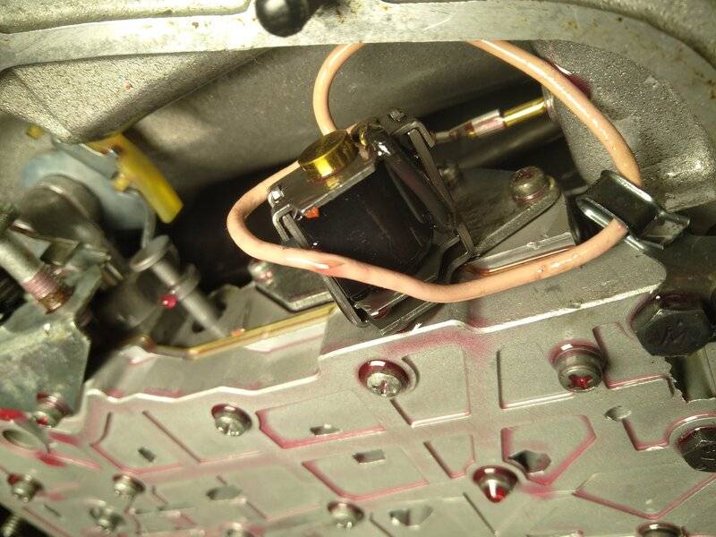

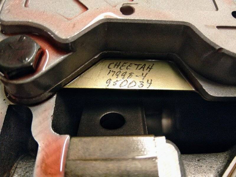

This valve body is installed in a 727 that came with a 440 i just bought.
Can anyone tell if it's a "RACE ONLY" type?
This may be a dumb question, but can/should it be used in a street driven car?
The 727 in my RR need some work, and i was thinking about using the transmission with the Cheetah Valve Body during this period...

I can't find a listing for that valve body. Found 17899xa, but that is a full race transbrake body. If yours doesn't have a tranbrake solenoid, that's not it.
I was gonna suggest you call their tech line, till I saw you are in Norway. Maybe an email to them will work. Turboaction.com. (it looks like most every body they .make is full manual.)

Looks like it's got the Tranz Brake...
Nice piece, I'd run it. I love my tranbrake, but you need lots of traction, and LOTS of drivetrain strength to make it work (and not scatter drivetrain parts everywhere.) My car is light, meaning I probably was overkill for the stuff I did, but I never broke anything either.
Like I said before, use the brake or don't, whatever you like. Without using the brake, should be fine on the street.
