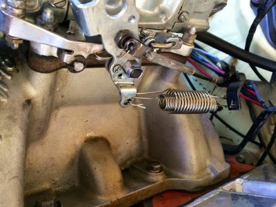

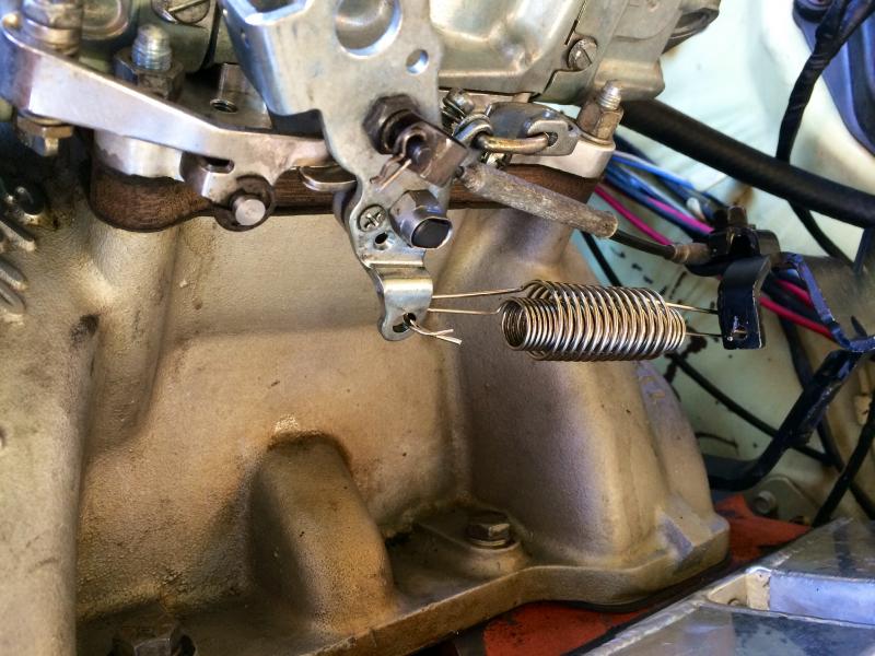

850 Demon. No choke operating. Predict 33 here tonight! Drove it to work. Warm up for 3-5 minutes seems to do the trick. I was just playing around with idle. I like 750. Here is my hokey throttle spring.
