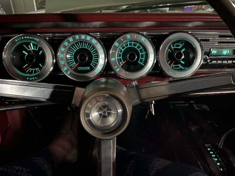

Well my Charger has started fixing itself. Over the spring I redid my dash with the help of Skatpack. And installed a Retrosounds radio. Put everything together and started putting some miles on it. Hit a little rain so I used the wipers and they refused to park. I figured I must have dislodged a wire on the back of the switch so I just shut the wipers off at their lowest point and figured I’d get into it this week. Well Saturday I took her out for a spin and about an hour into the drive the wipers parked themselves. I never touched the switch, didn’t hit any potholes or anything. And now the are back to working fine again
