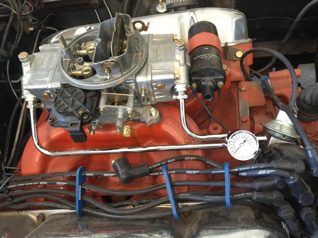

Is there a place to buy a pre bent fuel line that will reroute the fuel supply line from the mechanical fuel pump to the back of the engine. I just got my new chrome fuel supply line and the hose is touching the distributor. I'm not comfortable with electricity and fuel being that close.

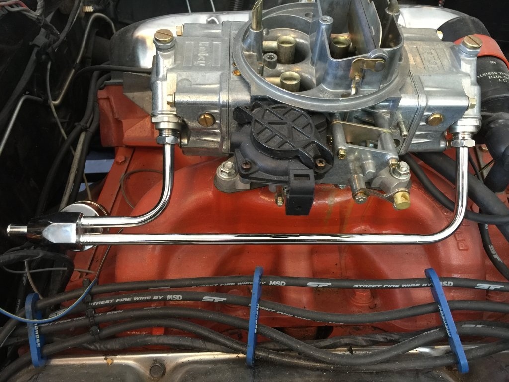

Well. I bought some 3/8" fuel line for $10. Got a tube bender. Then line is double flared and has the nut already on it. So I don't need a flaring tool. So I turned it around and it looks great. Except the fuel pressure gauge is now face down.
Looks good. Is it possible to drill and tap the other side for the gauge and then plug or cap where the gauge is now.
The fuel line came with a plug where the gauge is now. That's a good idea. Thank you. I just reversed it back so I could get it running. It's going to have to go on my to do list.
I know you bought flared tubes. If you decide to buy a flaring tool, make sure you buy one with the right angle. There are at least 2 standards (I think 45 degrees and 37 degrees) and they will not mix and match without leaking. I learned about this the hard way.
