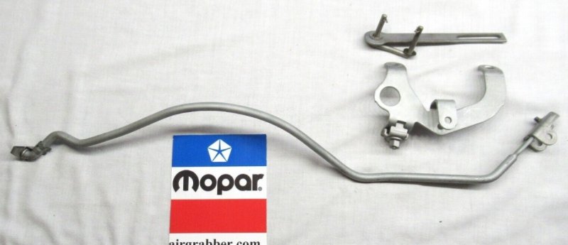

Tell me, would a 340ci 4 barrel linkage from 1974 work to correct the distance for the proper resting place needing?

OK, yours is the flat bar and not the threaded rod.
You could cut, add a section, and reweld the bar...
You could also try a bolt through the slot, and nut to act as a stop for the peg.
Bouchillon kick down cable is another option.

I went ahead and purchased a 1974 4bbl 340/360 kick-down adjustable linkage shown in picture. Will make the fit and finish nice. Hope it fits. I already talked with the seller.
THat is a step in the right direction. When you get it on and adjusted, if you have some slippage issues (hopefully not) you might want to drop the pan, adjust the bands and change fluid and filter. Like they say, "let's cross that bridge when we come to it."
