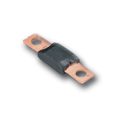

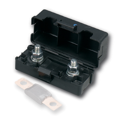

View attachment 93722View attachment 93723 I totally understand, they have been used forever with very little problems that doesn't mean that there isn't a better option. I have a lot of time and work in my engine compartment and don't to run the risk of a big black spot on my new paint. I wasn't referring to the link protecting the cars entire power source but the headlight circuit itself when I suggested a fuse "sorry for any confusion". You said there isn't a fuse big enough, this is the one I plan to use you can get them as big as 125 amp. Tell me what you think, any reason I shouldn't go this route. Here is a link to a picture of one blowing "probably an extreme case but nonetheless" oldfuelinjection.com/files/fusible-link-blow.pdf Sorry link doesn't seam to work but if you google it it will come up
There is nothing wrong with a fuse if it is large enough, the fuse you are looking at happens to be from the marine area usage. The fusible link is a pain to service but it is tried and true usage. As a rule we used 135% of amp load for a fuse under hood to allow for temp compensation. There are circuit breakers with push/pull on/off also that is used in the transit bus industry that you can use also. I do not blame you for not wanting to ruin your paint that could happen if the link was resting on the body. We place them as near the batt source as possible to have the most protection from a direct short. The breaker pic is a bussman marine available from a 50Amp to 150Amp which you could use also.
