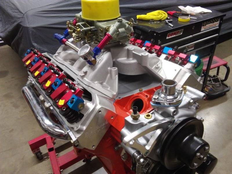

Set up the rockers with the spacers only. No shims! Snug the rocker shaft hold downs. Measure the total gap between each set of rockers. Using shims, set to desired gap(.015-.025). Remember, the rocker hold downs can be adjusted side to side a fair amount. Might be hard to see, but the total gap is marked on the yellow tape. Example: If total gap is .098", subtract the desired gap from .098. This will be the shim pack required. A little time consuming. I set mine at .018"
