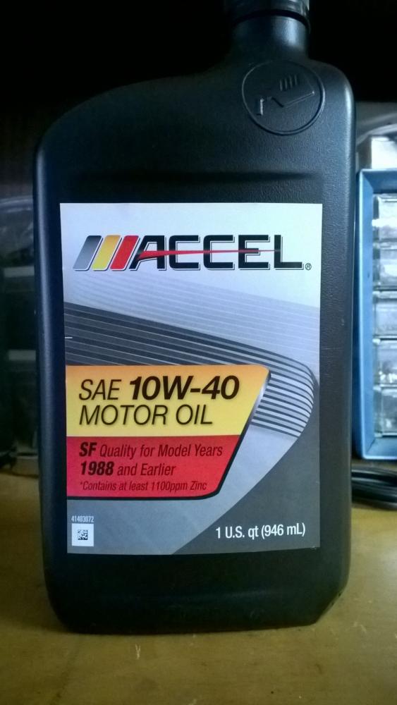

I've been using this but it is getting harder to find.
At one time Walmart had it but I haven't seen it now for months.
Contains at least 1100 ppm Zinc

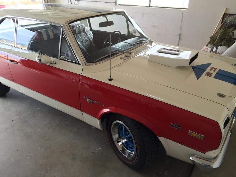

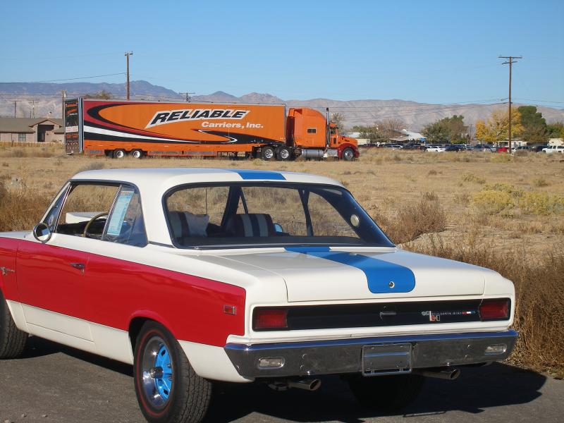

Okay, ALL GOOD INFO!
It seems we all agree that ZINC is an important additive for the Muscle Car Valve train.
Now, Weight Specific?
I recently picked up a 1969 SC/Rambler
Gorgeous car!
Well taken care of.
Old timer (like myself) always ran 20W-50 in the 390 engine.
To me, a 20-50 OIL is very thick.
I recently purchased Brad Penn 10-30 from Summit Racing.
Any input as to WHY we would need a 20-50 oil in our cars?

How oil is labeled depends on when it was produced. Oil for sale produced and bottled before legislation becomes effective does not need to comply. Notice in post #10 he goes on to say he can't find it anymore.

Yeah Rick, only place that seems to still have it is Amazon. And I am going to order a case or two before it is all gone.
Otherwise I saw great deals at Carlisle in July. It is not the same stuff but has the higher ZDDP. I will pick some up there as well.
