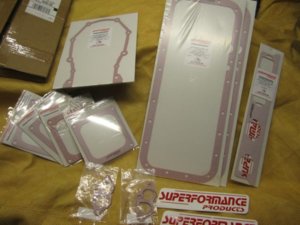

Ask Greg at http://www.superformanceproducts.com/. I use all his gaskets except head & exhaust 'cause he doesn't make them.:thumbsup:

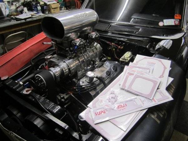

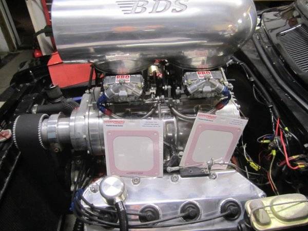

Just a test fit......... now for putting it all together especially throttle cable and fuel lines......
