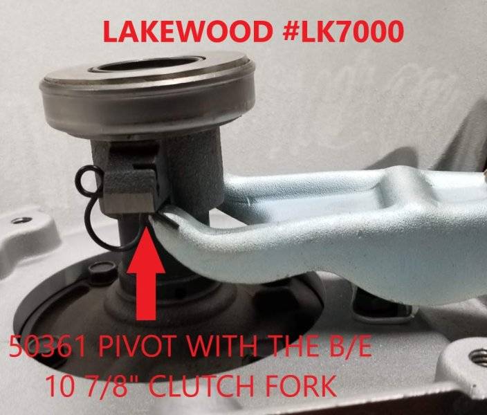

I'm using a Lakewood LK7000 bellhousing for the 4 speed swap in my 1971 Plymouth Satellite Sebring. I'm having problems getting my clutch fork to align properly.
Does anyone on here have any suggestions from experience? I'm using a clutch fork from Brewer's Performance with the clutch pivot from the Lakewood kit. The throwout bearing won't stay on the fork because the fork isn't close enough to the centerline of the transmission.

That's all correct. The problem is inside the bellhousing. The pivot point for the clutch fork is too far away from the throwout bearing.

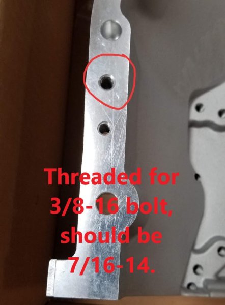

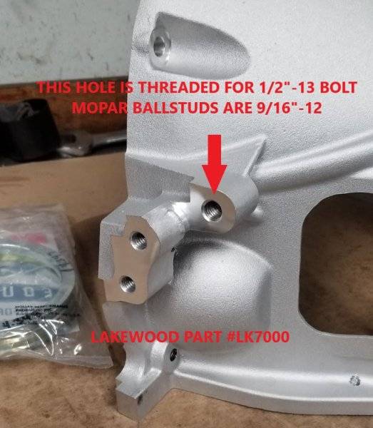

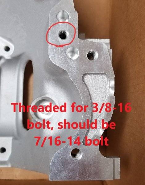

Here are my notes on the LK700 bellhousing when they first came out...not sure if ANY of the issues have been fixed or not. The problem with the pivot is that the holes are not drilled/tapped in the correct location.

Thanks a lot. I managed to fix the thread size for the z-bar pivot with the bellhousing in the car. I'm lucky to have been a machinist at one point so I had everything I need. I got the clutch fork pivot to work correctly with a bit of modification. In all, the car is back on the road.
