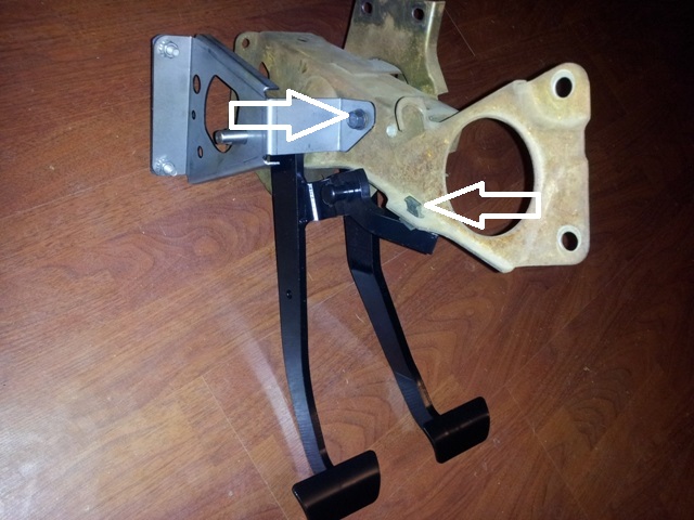

747 Mopar . . . I bought an adapter from Brewsters Performance and added it to my Auto brake pedal to get the man pedal into my car. I have not hooked it up yet but it looks like it should be able to be done. I've got the pictures documented in my build thread . . .
I think you should be able to pull the parts off the one assembly and add them to yours to make it work . . .
Page 31 - post 606 shows the new parts added to the original . . . nope that helps . . . ( duh . . . add it here ! )
