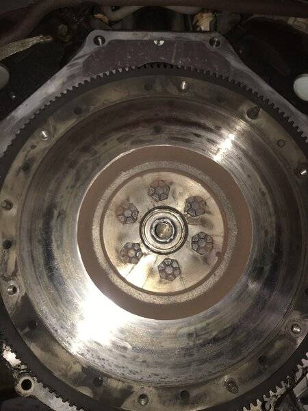

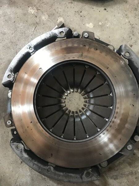

Putting a new T5 in my neighbors Mustang. I know... Anyhow, he says the clutch is new and I believe it is. But since his cable was stretched out and it would never fully engage the clutch I told him he would most likely need to replace it. Well I took it all apart and here are some pictures of the Flywheel and Pressure plate. Opinions.... Replace or use it...
Replace the clutch and pressure plate, have the flywheel surfaced. Replace flywheel if any cracks show.
I am taking the flywheel to get it resurfaced this morning.. And I agree with Richard lol.
Your dilemma comes down to the age old question; time and/or cash. If you wish to get more use from the parts you have now, knowing they will wear with use, stick em back in, knowing you or somebody WILL replace them in the future. How soon, depends on how hard you run them. If you have the time and resources to easily replace, run em. If on the other hand, you want to get the most miles behind you before this job HAS to be done again, chunk your used parts and replace with new stuff. For me, I have tools and equipment to do these things whereas other folks have to pay someone to do the job and if thats so, its prolly cheaper to go with new stuff NOW.
