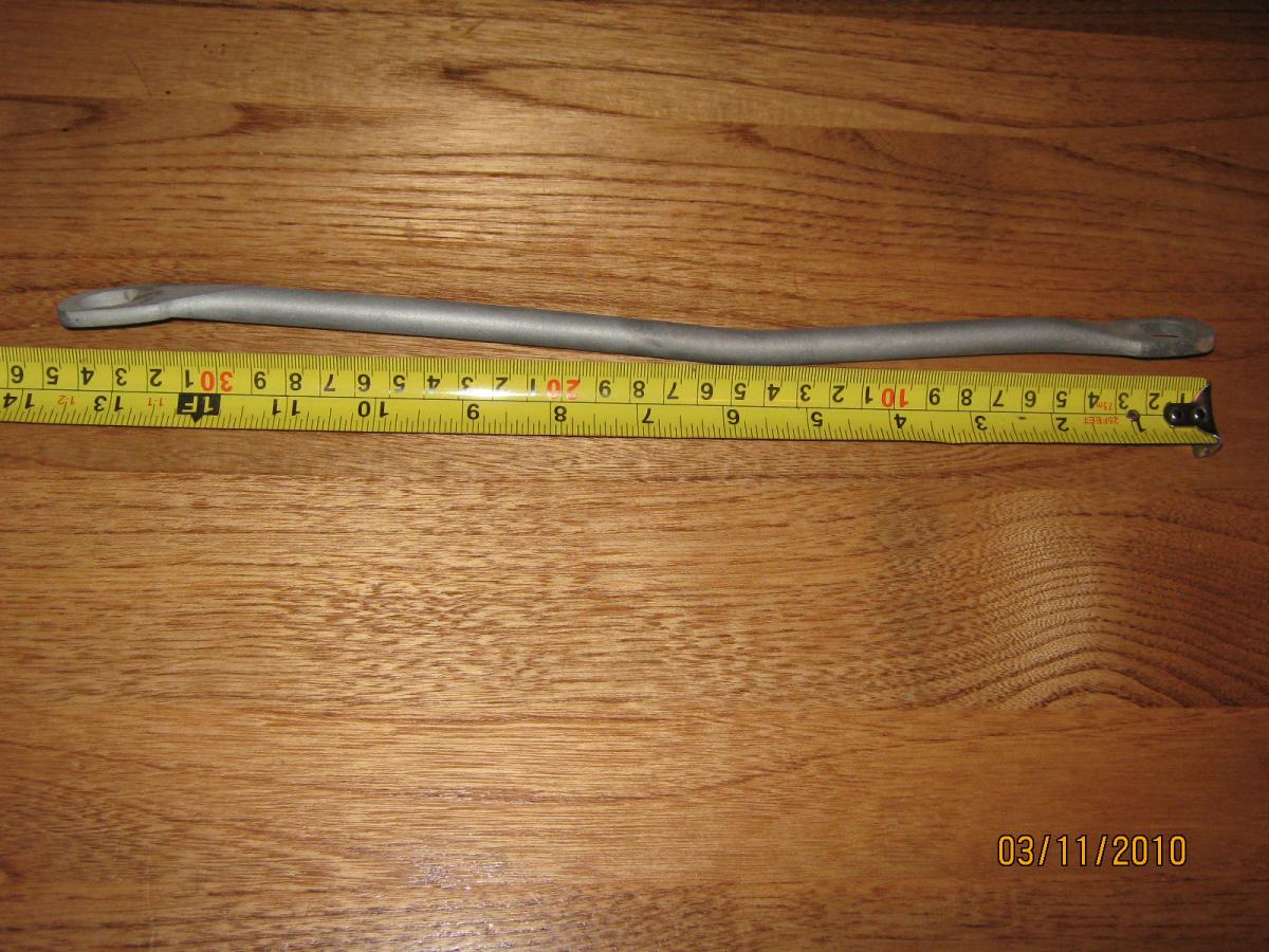

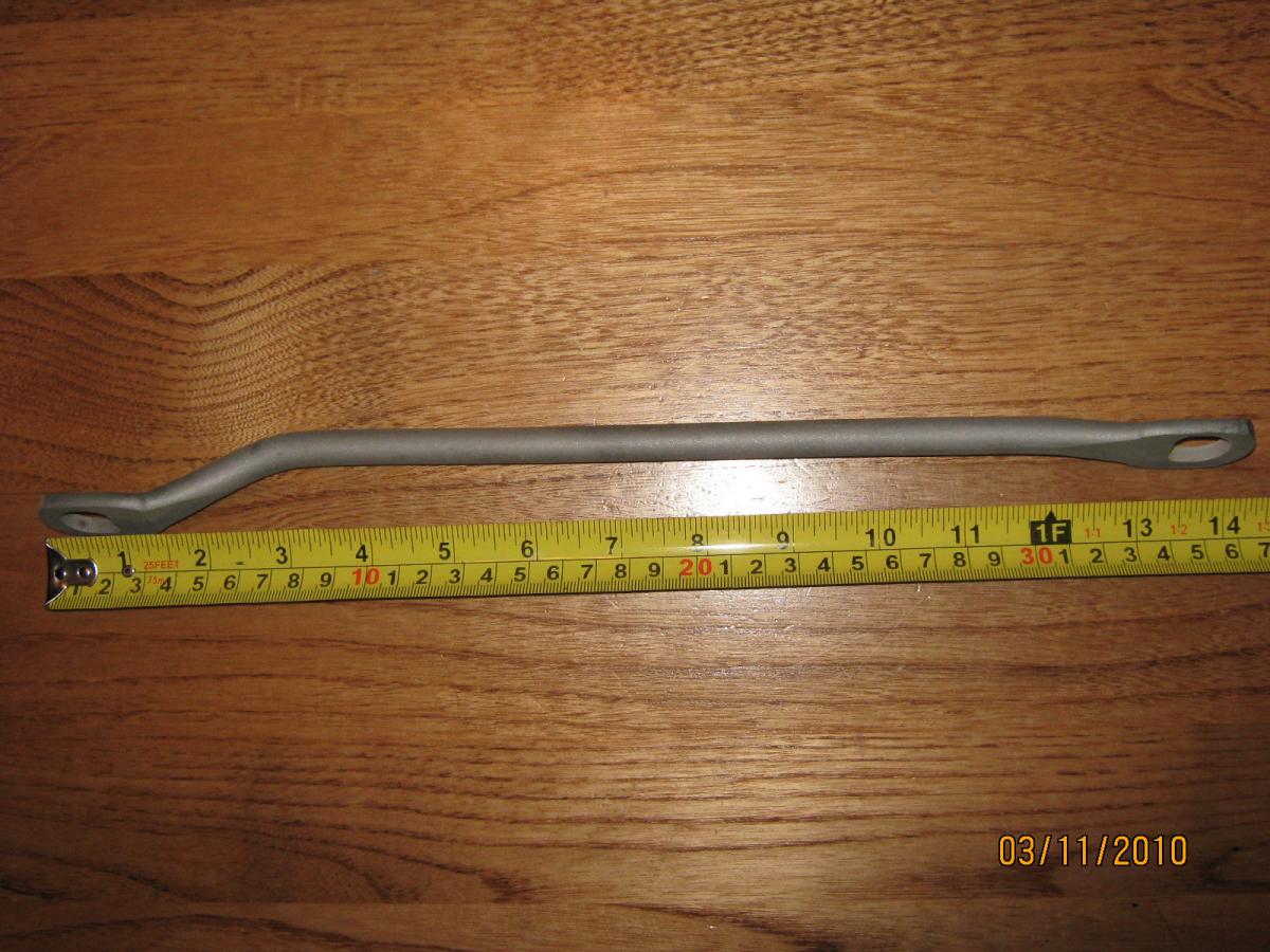

The bends are differnet. The first picture is an A-body and the second pictures is the B-body. The pictures show froma side angle the bends and length on the tape. Also like has been mentioned before Brewers performance has a great site with alot of info.
