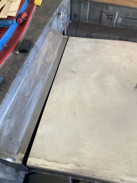

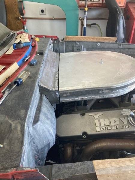

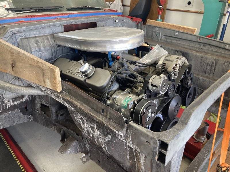

I almost changed directions on my set up to be similar to yours. In a previous issue of Racecar Engineering where they did some CFD work on an older T/A car that races in Europe. They modeled a few possibilities of air intake systems and the forward one, on a mid 80's Camaro, would work the best[ along the line of yours]. I looked back at doing that but there would have been a lot of redo work for me. Especially on the core support as I made mine up from scratch. I also looked into making ducts to tie into the lamp buckets and use them to feed the engine. I can mitigate some of the heat absorption on the filter unit utilizing some thermal coatings. But thats down the road if I feel its REALLY needed.
