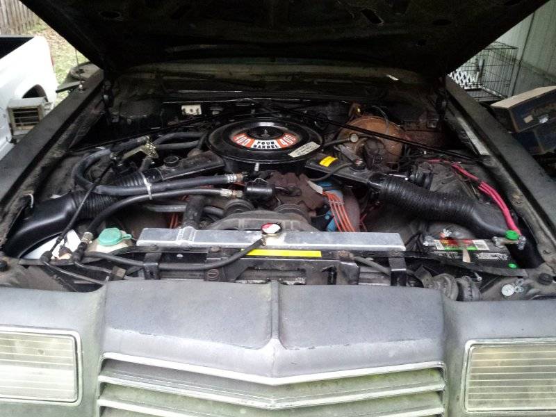

Heres my 78 magnum with a home made dual snorkel to the radiator core support. mimicing the drivers side fresh air ducting. Mirroring the drivers side oem plastic duct was a pain.
From what I read in the Race Car Engineering magazine awhile back, the best intake area was in the front by the lights or just under the hood edge. The used CFD to show various intake areas with colors showing temperature variations of the different configurations. The cowl wasn't bad but now what was initially thought. The worst was having a hood set up to vent the hot air from the cooling systems/underhood heat etc combined with a cowl induction setup. The hot air contaminated the cool charge massively. Same goes on the usual open element that many of us use without any ducting. On my setup, I was looking into the front style with modded light buckets, with ducting outside of the lamp to catch air, plus getting the light bezels 3D printed with larger light openings to feed the ducts but not affect the basic look. After looking at a dudes 64 to imagine routing etc, plus added in the fact I would have to totally redo the core support I made from scratch, I did what you see.
