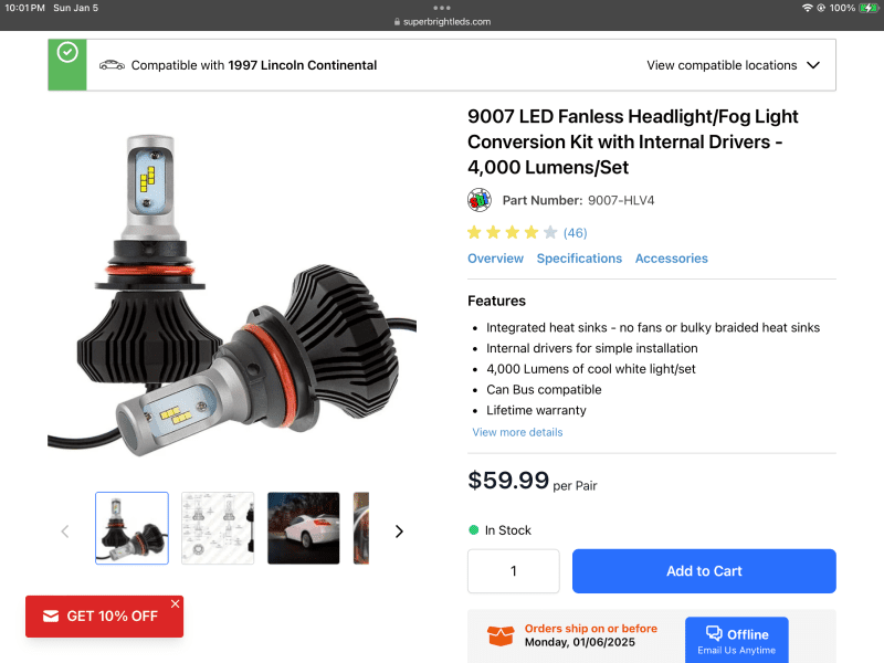

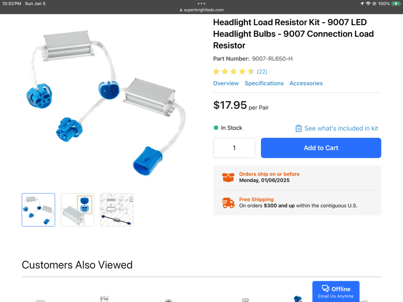

Fast forward to a couple of months ago when I decided to try again with the leds in my newly aquired 1997 lincoln, because the headlights were very dim compared to what I am used to with my 2021 Tacoma. I was skeptical they would work but they did. That setup you are considering looks like the same setup i used from superbrightled.com for my 97 lincoln, but without the headlight housings that replace your sealed housings. They work awesome in my lincoln, but i did have to use the resisters.
But as I said above I’m not sure leds will solve your problem. Have you considered the headlight conversion from cracked back who is on this forum? He makes and sells plug and play harnesses that change the way your car regulates the voltage to your headlights. I have it installed in my 74 Road Runner. Very high quality stuff and very bright. Installation looks factory professional, and the stock sealed beams shine realy bright. No modifications required to make them fit into you car.
If you decide to go the LED route, the $500 they want for that kit is ridiculous. I did my lincoln for $80 minus the headlight housings. This is what I got from superbright LED. Like I say it works in my lincoln but that car has a more sophisticated charging system than our older cars. I got the headlight conversion wiring harness from cracked back for around $180 IIRC. I highly recommend doing that over the LED. It’s guaranteed to fit and make your headlights brighter. Install takes about an hour. The harness comes plug and play and is guaranteed to work. You dont have to do any wire splicing or modification to your car. The harness can easily be removed if you want to go back to oem if its a number matching car.
View attachment 1785057View attachment 1785058
