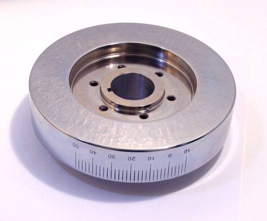

Wondering what the general consensus is on a fluid damper. Yes, they are expensive. The claim is they should be used on a modified engine but the 440 is internally balanced. Waste of $? Just want to hear the community’s opinions. Thanx
Got this one for sale. Not expensive !! 440Source - brand new $ 135..

I'm not sure I get your point. Every engine needs a damper of some sort. The only drawback to putting them on every engine is their expense - due to the manufacturing process. Also, a "fluiddamper" can only be used on internally balanced motors.

I bought a 440 Source damper because I don't plan on racing and because of the obvious rubber
degradation and indexing problem you are having on a fifty four year old P.O.S! The ring inside floats in
a silicone liquid and dampens vibrations in the crank and some from the valve train. For $135.00, you
can't beat it! I wonder how much a stock one would cost??? If you are going to race, Spend the cash
and buy a "Fluidamper"(Brand name)
For $135.00, you

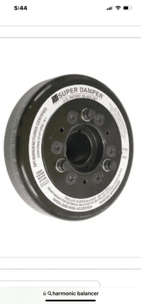

I've run a couple of Fluidampers on drag engines, worked fine.
I had a fluidamper eat into the crank snout on my Supra due to poor machining tolerances. It was really difficult to get the fused part off the crank. Almost destroyed a very expensive engine.
At that time which was about 10 years ago I wasn’t the only one to have that issue.
Maybe they have less issues these days but I will never use that product again.
I switched to an ATI super damper and haven’t had issues since.
Yeah right, 'cause y'know - if one's bad then they all must be bad !!
Most aftermarket Dampers need the hub fit checked. They may need to be honed to fit. If not the crank can be damaged. My racecar had a Fluidamper for years. When it had the rod bearing failure last year the Fluidamper was cracked and leaking fluid. It has an ATI now.
