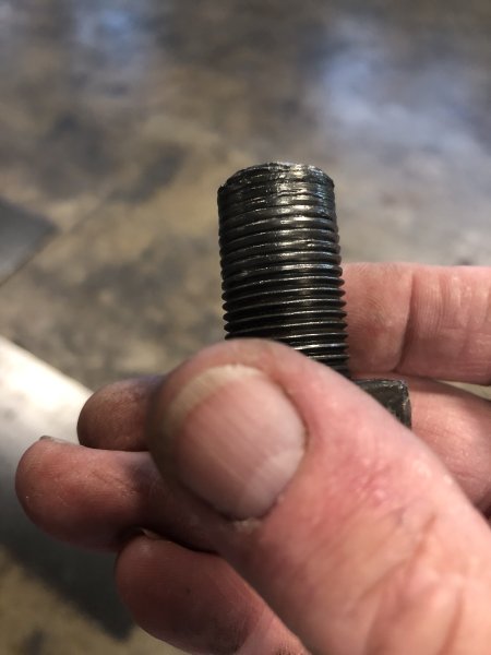

Agree with hofferwood. If your going to use the die to add threads the shoulder (unthreaded area) will need to be turned down. Measure the diameter of shoulder, measure the threads. The die won't cut the larger diameter shoulder down, I believe.

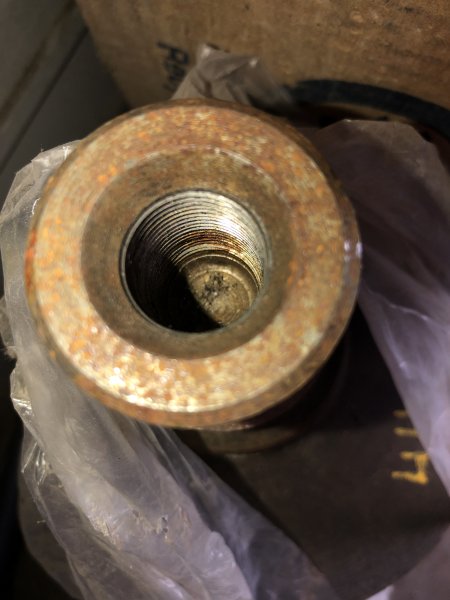

Please tell me what this is. Thanks!I use the 1/4" rope method in either #6 or #1 (depends on my mood) to tighten the balancer.
As mentioned if you can tighten it to 135 ft/lbs your worries are over.
This makes sense, but I'm thinking I might just add a 2nd washer (?). I have to get the pieces in my hands & measure everything to be sureAgree with hofferwood. If your going to use the die to add threads the shoulder (unthreaded area) will need to be turned down. Measure the diameter of shoulder, measure the threads. The die won't cut the larger diameter shoulder down, I believe.
Roll #1 to around to around bdc you want it to be coming up (#1) to compression (both valves closing) pull the spark plug and stuff about a foot or two of 1/4" rope inside the cyl (DON'T LOSE THE END). Then you can torque the bolt--------it stops the motor from turning.Please tell me what this is. Thanks!

First 2 threads trashed inside the crank. The tap pulled out a lot of metal, but it was mainly bolt, not cranks (Thank the Lord). The fix worked greatWhat does the inside of the damaged crank look like? How far down are the threads damaged?
