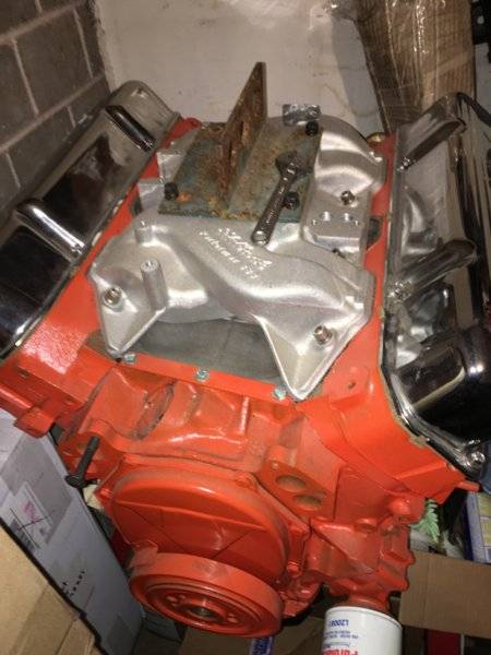

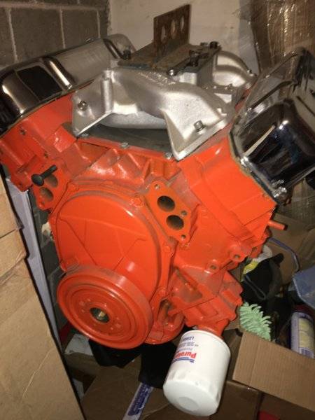

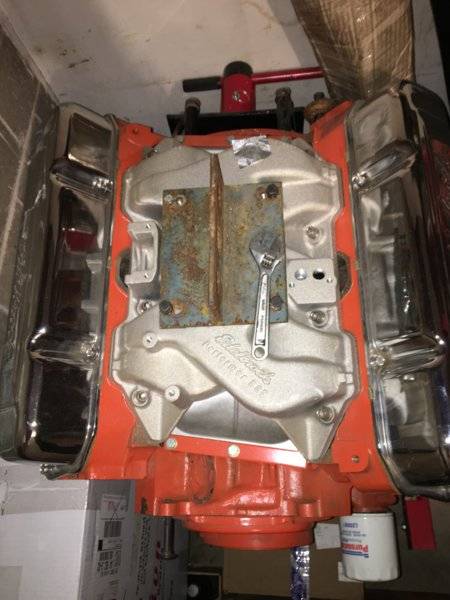

Hello wyrmrider I am going to take a step back,heres my story my brother had this 383 built by a reputable engine shop 8years ago the engine has never run since rebuild unfortunately my brother passed away and I inherited this engine. All I can tell you right now is the engine is a 1966 383 built up to factory 375 hp. I am going to have to take it all apart to verify what they have done inside piston, bore, cam, ect ect.I will then know what Im dealing with and where I wanna go from there. Thank you for all your input ill keep you posted with what I find

ok check the valvesprings the ones that have sat open may have taken a "set"
on the cam see if it was liquid or paste moly cam lube I like paste better
best to loosen rockers b 4 you turn it over (much)
