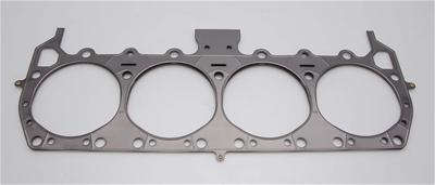

So the question is are the gasket bores round? If they are you can figure the volume of just the gasket with the above formula but use the .040" as the stroke. What is 26.7? The volume in cc's of the valve reliefs? Assuming so this will get added to the chamber volume. 80+26.7+gasket = unswept volume. Gasket volume, assuming the bore is at 4.35", which it probably isn't, is 9.74 cc's. Total chamber volume is 116.44 cc's. Add that to the cylinder = 1151.44 cc's. Now divide that by 116.44 and you have your static compression ratio of 9.88:1

Easiest way to increase your compression from what you have here is to go for some steel shim head gaskets (only use with iron heads). For every approx .035" reduction you'll gain a point of compression.
This should get you another half a point: http://www.summitracing.com/parts/dcc-4286754?seid=srese1&gclid=COPVnsrn_bYCFelxQgodyWAAng Oops - just noticed you had stealth heads...try these: http://www.netgaskets.com/COMETIC_Head_Gasket_CHRYS_361_383_413_440_4_35_p/cometic%20c5460-a.htm

i already have .040 compressed thickness cometic head gaskets on with 0 deck height
That's why you want the .027 compressed Cometic gasket. Looks like you'd at least raise your compression 1/3 of a point. Easiest way to get there....
