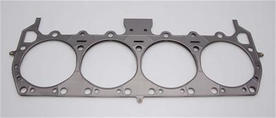

they are almost round slight oblong shape View attachment 115643
My point about the round gasket is you can't accurately calculate the volume, or let's say the long hand involved to do that is far beyond me! You can get close, and if you had a good feel about guessing volume that might be good enough. Better to just pour it.
