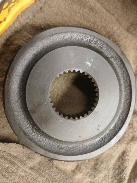

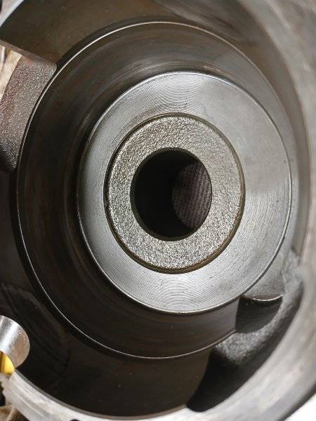

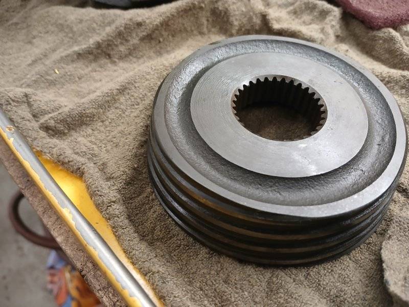

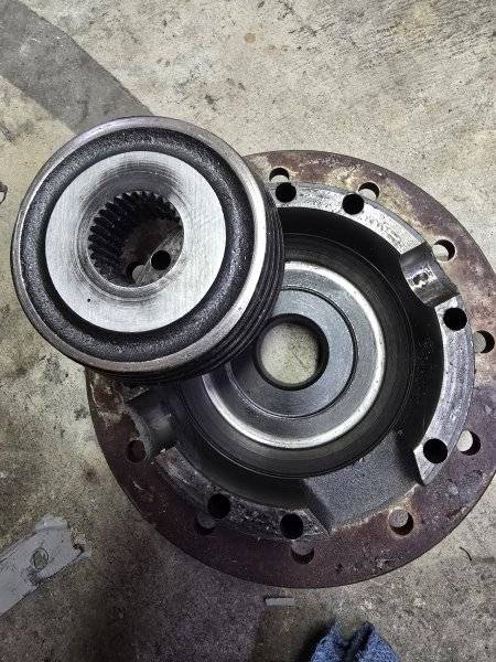

I have a couple of cone style LSD's currently in 741 cases with 3:55 gears. Is it possible to determine on the bench if these will need a rebuild or not. Without actually testing in the car, can I tell if they will function as designed by a visual bench inspection.

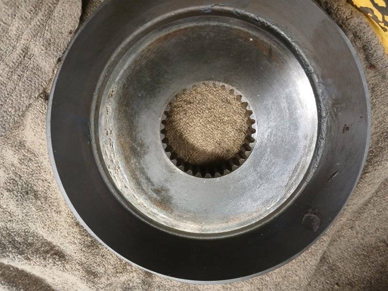

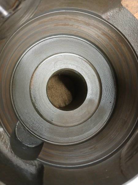

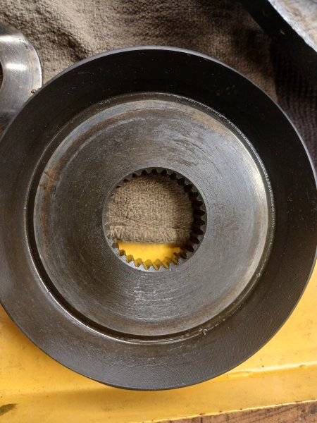

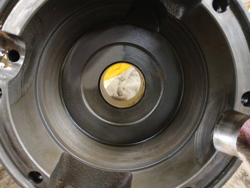

Mine was so wore out you could see where the cone bottomed out against the housing. Dr diff has a repair kit for this. I haven't tried it yet though.
