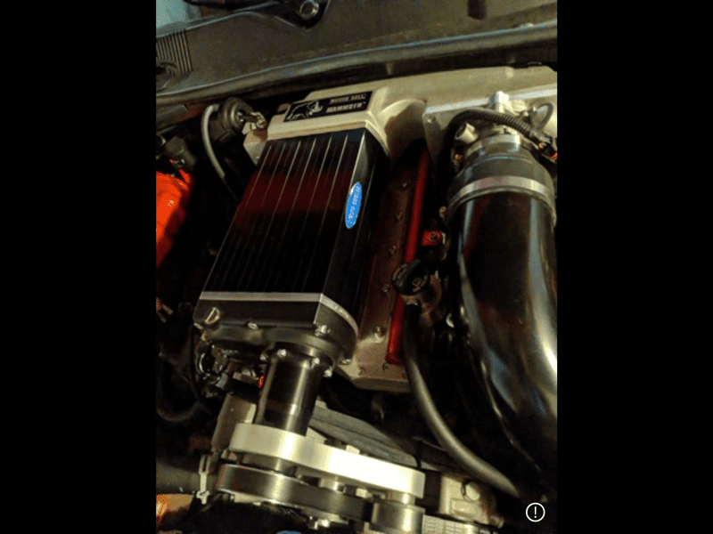

I am currently piecing together a 7.0L stroker with supercharger to replace my 6.1L - I am running a Viper T-56 with 3.55 gears - but I have a 3.91 pumpkin waiting to go in as well.
