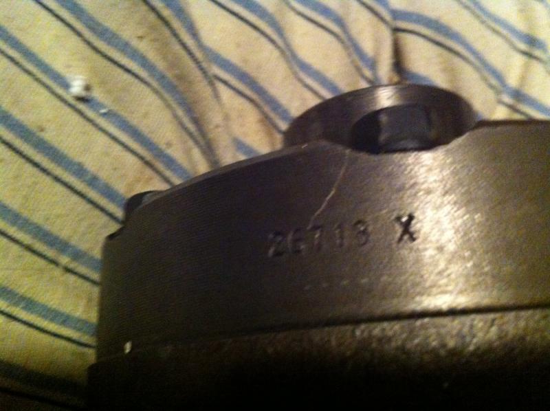

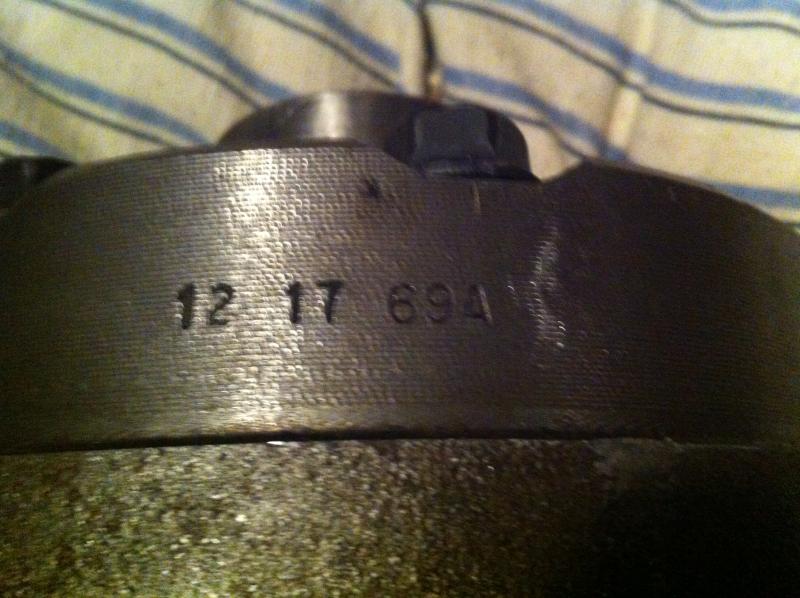

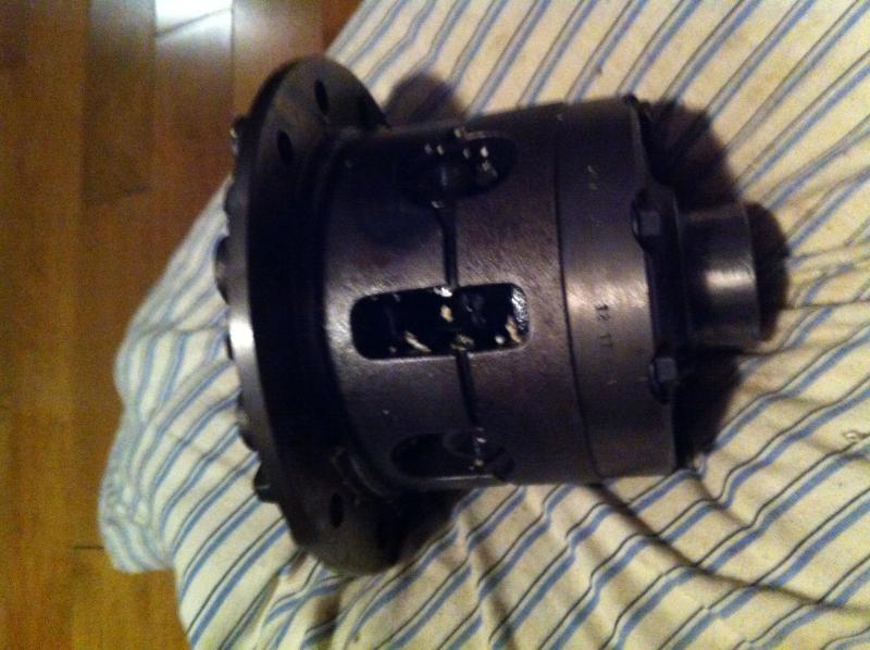

Sending some pics with# my pm is [email protected]. This is a dana 60 unit IMG_0101.jpgIMG_0102.jpgIMG_0103.jpg

UPDATE: We got our answer HT413 you are correct it won't work unless we have a 9 3/4 Dana rear end
Update to my update... I now know that I have a 742 unit. The guy doing the work on my car right now says he can get the pro series auburn position for it which he says is a good setup for $675... How does this stack up against what Dr. Diff is offering?

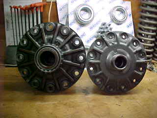

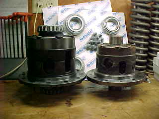

A Dana 60 carrier unit (the SureGrip unit or posi) will NOT fit into an 8 3/4. The Dana 60 carrier is much bigger and 'carries' a larger diameter ring gear. Here is a pic of a side view...the 60 is on the left. Moot point now but at least you'll know the difference between them.
