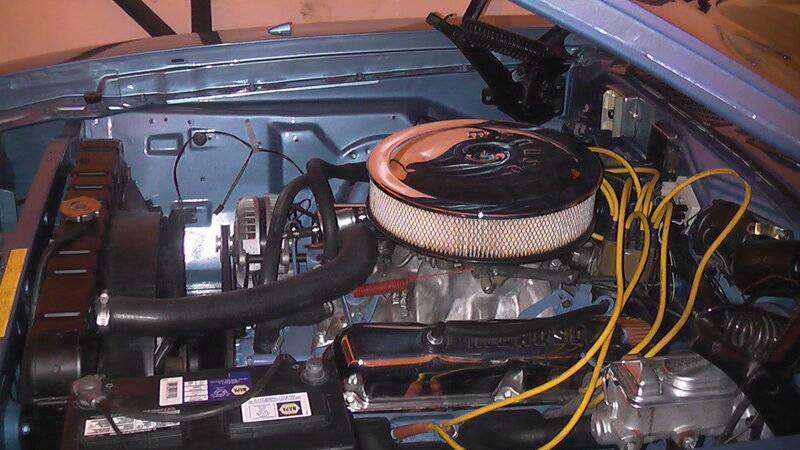

hear a old pic just the same as now .
The fact that it stays cool while cruising tells you the fan isn't moving enough air although other things like your tune could be contributing to it. This also tells you that you don't need a bigger radiator just more air.

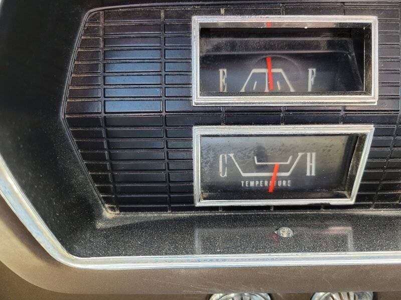

As above, you have to know "actual" temp 1st. The C - H gauge shows a very wide operating range. A 170 stat starts to open at 170 and generally fully open at 185, 15° above stated opening temp. At idle, in heat 122°, 496" engine w a/c on, I'm at 220ish and my guage is still in operating range. Highway I'm around 186 w a 180 stat. You're probably normal, "may" need a new fan clutch, or may need to adjust timing/AFR. Start there before throwing money at it. And yes, a new engine runs hotter for a while.
well my needle was just a little further close to the next line, your at 220 so maybe 225 is what mine was, once it reach that i went home.
For $15 go to Harbor Freight n get a IR temp gun. Then when your engine gets hot, get a reading at the temp sending unit. Guages will read different. Don't guess.
