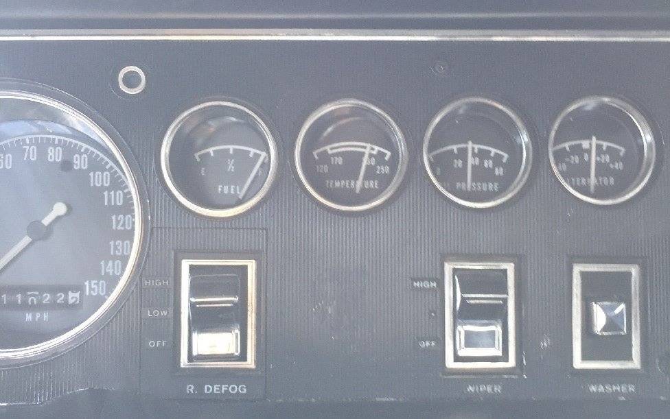

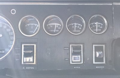

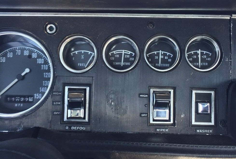

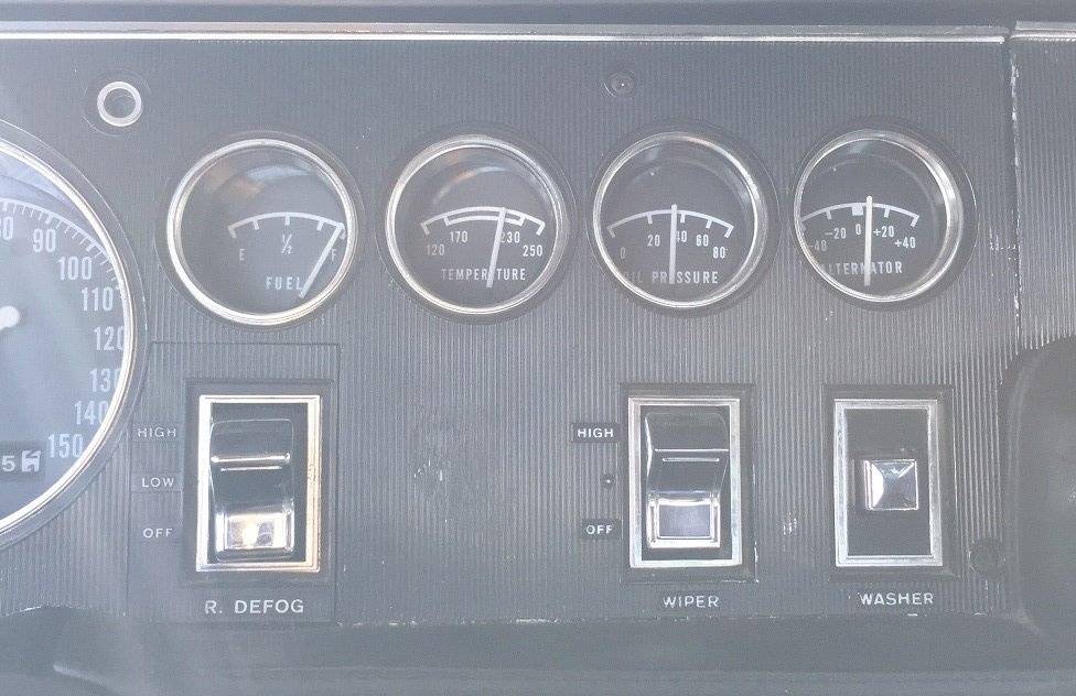

4. I took out the Thermostat today... it was hot outside today. The old thermo was a 180. I installed one hi-flo Mr Gasket 160 thermo instead. I started the car and let it idle for a good while. The outside temp was about 30 degrees though felt much higher. Anyways, for 20 minutes of idle, the needle moved only 25% towards the center from cold. I then did a 30-40 minute drive through traffic slow (average speed 20mph) stopping at many lights and the needle moved over to the 75% mark from cold toward hot. It didn't go much higher. I kept driving till I came over to highway and drove the car at 65mph for about 1.5 miles getting off at the next exit. The needle dropped down to the center and then from there remained kinda centered till I got home 15 minutes later driving slow. Here are the pics as I took them in order. I hope that my car is not running hot still. I am going to purchase a Radiator Shroud (steel one is expensive but thats the one I am going to get).

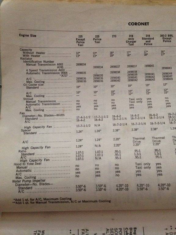

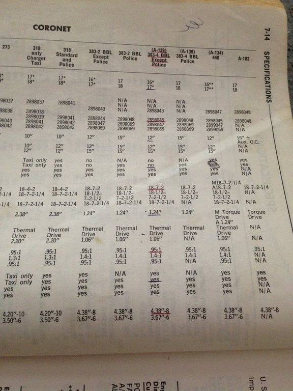

Straight out of a 68 FSM, I tried to include BB's also in case one of those lurkers looked.
In a nutshell an a/c car used smaller impeller(less fins),7 blade fan & higher ratio pulley for the belts; spun everything faster if I'm figuring right.
