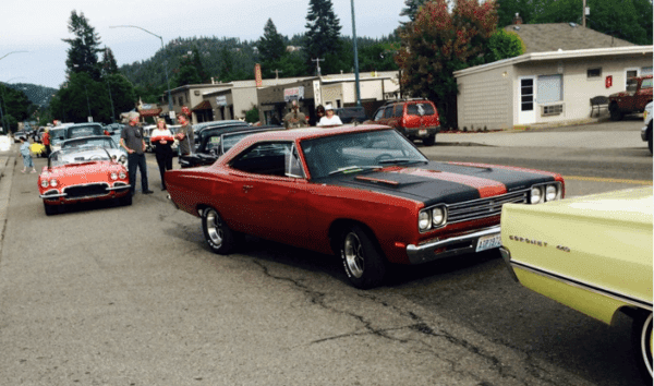

My pops painted it that color before I bought it off of him. I like it :)

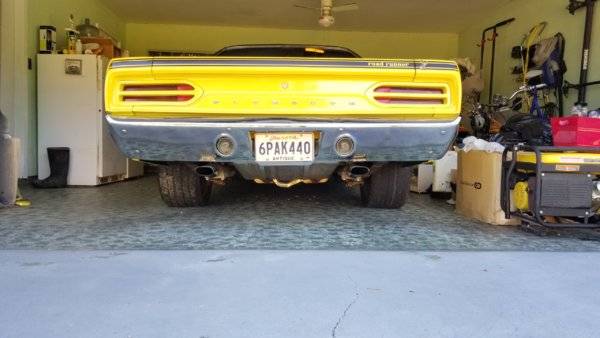

315/35/17 Toyo Proxes TQ drag radials on the Year One 17" x 9" wide rear aluminum Rallye wheel. Stock suspension. Fits like the factory should have equipped my 70 Roadrunner with them. No rubbing anywhere, ever.
