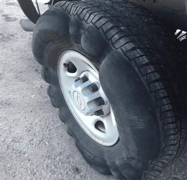

Those are BF Goodrich.

Kinda depends on how much you value your car & the people who ride in it.... In the case of the Challenger in the video posted above we slowed from 75 to 55 and drove about another 8-10 miles hoping to nurse the car home... It was getting worse.... It rode home on a tow truck.... And now has new tires... Mickey Thompsons this time....
This isn't the first time I've seen a separation, back in the 70's & 80's Firestone was well known for them... But something in tires has changed & they are failing a lot more than they did twenty years ago
Replace ! Friend had his tire separate and mess up his lower quarter panel
If you blow a tire and ruin a fender or quarter panel, that’s one thing. If you end up on your roof in the ditch, you’ll wish that you’d put tires on it sooner…

I've got a Challenger that hasn't been driven on the road for at least the last ten years; the tires are probably 10-15+ years old and look to be in PERFECT condition. I went into my shop the other day, to discover that a tire had gone flat. Upon examining it, I discovered that the belts had separated and torn apart! So, apparently tires WILL go bad even when not used much and protected from direct UV light!
