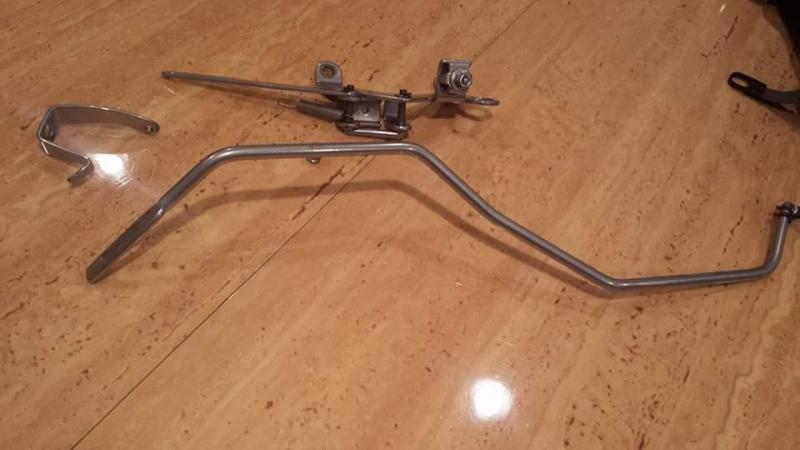

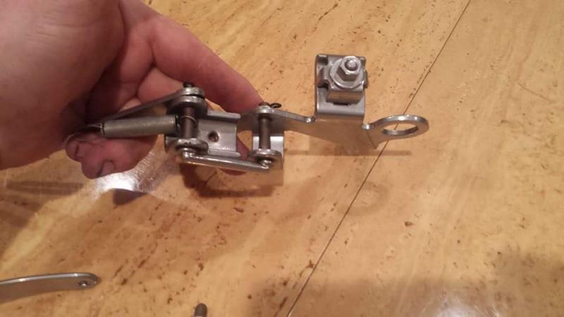

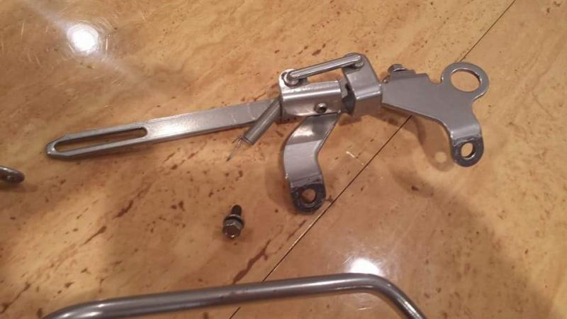

I am wanting to buy this cause the price is right for me. He says it came of a 73 charger 318 2barrel with a 904,but mine now has a 4 barrel. Will this still work?,,,I know Lokar is best way. To go,but unless y'all have a set up for sale I can afford can't get one cause new with. Carburetor bracket lokar FB_IMG_1423089845038.jpgFB_IMG_1423089871442.jpgFB_IMG_1423089891846.jpgis like $120.

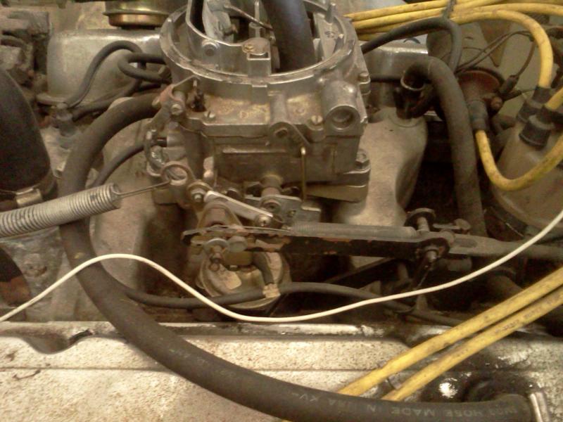

I just took a pic of a performer intake fitted with the 360 bracket and my 73 318-2 bracket laying on top of it.

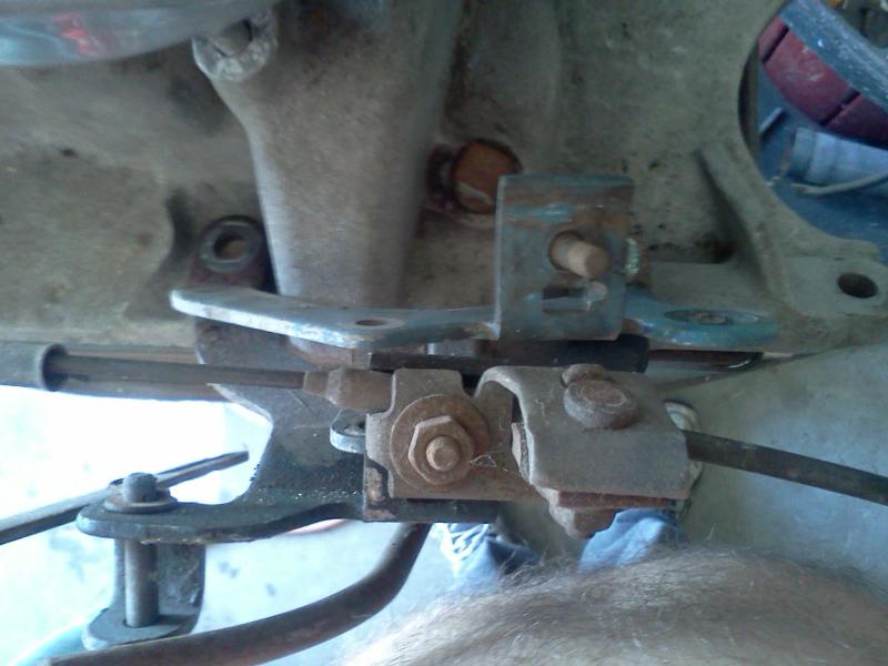

I also have a pic of a simple modification to a factory 2 barrel bracket, that was on a parts car I had a couple years ago.
Looks like a piece of 3/16 aluminum bar stock, cut to size and drilled, used as a throttle cable extension.
Note the 360 bracket also has a cruise control cable mount, and the kickdown stop on the 2 barrel bracket.
Something else to consider is that most SB throttle brackets were designed for use with a spreadbore TQ.
That puts the cable an inch plus outboard of the location for an AFB/AVS.
(as seen in the first pic)
Might help...
