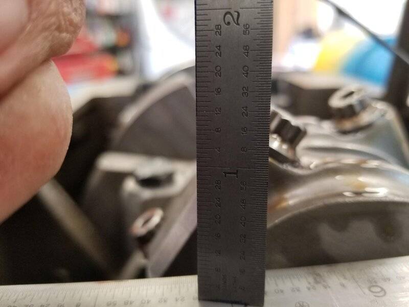

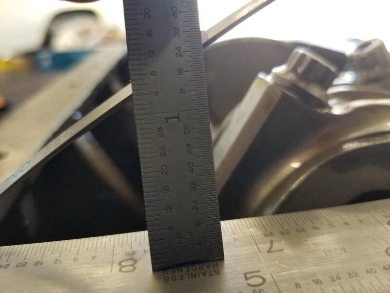

What is the correct oil level in relation to the rotating assembly? I am building a 494 CID with 4.150" stroke and am using Hemi 6 qt. pan. Right now the full dipstick mark is about the same as the lowest point the bottom of the connecting rods see. How far into the oil surface should the the crank go at startup when the pan is full? I'm assuming this is how to determine correct oil level, correct me if I'm wrong.

The Full (6 qt.) mark on the dip stick sets the static level about even with the rod bolts at lowest point of rotation. I'm thinking that when circulating it should be safely below the stroke but plenty of supply?
