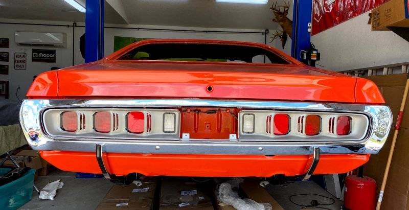

This rear bumper was in bad shape. some one welded a trailer hitch to it.
